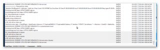

After hours of searching I found the smspxe.log.....
it looks like my certificate is the problem.
I didn't make any changes on it but I will look into it now.
Hello again,
I found the problem to this case.
the certificate has only SHA1 and I updated the SCCM to Version 2107.
After the update the Clients can't connect to the SCCM ( weak algorithm )
