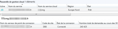

However all seems be alright :

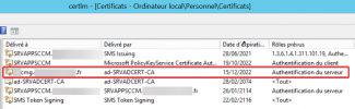

Based on the following screenshot, there is an issue on the remote certificate, re-check your configuration and certificates.
Here is my mmc for certificates on my SCCM Server.
SRVAPPSCCM is my SCCM Server
xxcmg.mydomain.fr is the CNAME for my CMG.
xxcmg.cloudapp.net is my Azure Deployment
In my Server certificate i have added CNAME : xxcmg.mydomain.fr .
I have also register the CNAME on my Web Host control panel (xxcmg.mydomain.fr > xxcmg.cloudapp.net).
So what do you think about my configuration ? Do I have to add any other information in the server certificate?
The DNS seem's right :
And here my CMG Config :
Problem solved. I have changed the configuration of IIS and now it's working fine.
The SSL certificate was wrong so i have replaced like above.
