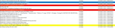

Hi folks,
I'm trying to install the client manually on one of my DCs but i get some errors (see attached screenshot)
I have already repaired the WMI repository.
The issue is still not fixed.
Many thanks for your help :)
I see the client agent has been installed - ccmsetup is exiting with return code 0.
Hi Prajwal,
many thanks for your reply.
I see I can access to configuration manager but the client doens't get the certificate.
Also, there are only 2 actions available in the list.
Software center was not installed either.
Now that makes sense. The client agent is installed but the assignment process is failing. You need to check the clientlocation.log, locationservices.log, clientidstartupmanager.log for errors. Before you do that, make sure that you have the correct boundaries specified.
Boundaries are correctly set.
This is my ClientIDManagerStartup.log
I've got these errors in locationServices.log
I cannot see any error in the clientlocation.log
Your management point server is probably offline and is not accepting client registrations. Ensure you MP role is up and running.
Hi folks,
There were some bad network settings on the server as well as it was not excluded from the firewall.
I no longer see errors on my logs except on ClientIDManagerStartup logfile which says the client is not assigned to a site so far.
The client still can't get its configuration (no certificate, no GUID...)
Finally, the issue is fixed.
I have reinstalled the client which is now working correctly.
Many thanks again for your help guys :)
