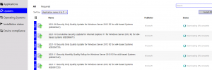

  • I can't see the updates in Software Center on the VMs
