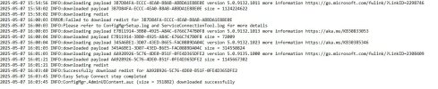

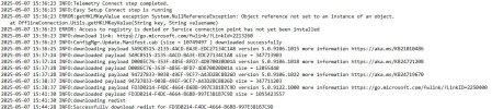

Now when I actually go to that file location I've found the file, but it is 0KB. I digged a little further in and looked into the .cab file in that was contained in prior and that same .exe file is 0KB there as well along with several others(Pic attached). So makes sense it would fail it is trying to install an empty file.
When I looked at the serviceconnetiontool.log (pics attached)i see an error for access to registry denied then 1-2 errors to fail to download redist for the some larger .cab files, however invested the ones with no errors and those still have the files missing.
