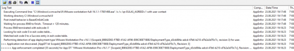

Ok in your initial thread you mentioned that clients are unable to install software. What error do you see and did you examine the appenforce.log ?. Can you log in to a computer and check actions tab under Configuration Manager properties. Do you see all the cycles ?

I dont realy got an error, simply after one sec. it says failed an i can retry to install the software.
It simply sayy, no changes to teh software can be done. Try later.(translated)
The last log is from 09.08.2021

I checked again the app enfoce ment,
Seems to be ok, i guess.

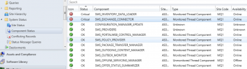

What is the status of MP_Control_Manager, is it online or offline. If Offline can you try to bring online.
Filter based on Availability so that you can look which one of them are in Offline and in red.

Hi vin418, thanks for your feedback. Actually the ESXI server are in the same Server room. What we did is only to move the SCCM Server and 2 others to another ESXI Host. And this we did with vSphere. The SQL is the one of the site server, not a seperate solution (Costs :) ).
The MP Control Manager seems to be online
In the logs i am not able to find anythink. No Errors
Not sure if i am looking right or not in regards of the Control Manager and if its online. Can you let me know where to look maybee correctly? Thank you again in advanced.

Not sure if i am looking right or not in regards of the Control Manager and if its online. Can you let me know where to look maybe correctly? Thank you again in advanced.
Hello Michael,
You may check all the status at Console >> Monitoring >> System Status >> Component Status.
There you will be able to find whether MP_CONTROL_MANAGER is online or showing offline.

Than you vin for your assitance. To anwser your question, the machine is reachable via ping nslookup. No DNS issues. The MPCM was online.
