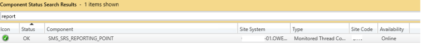

Did you add it as a reporting point within ConfigMgr? is it showing as healthy in ConfigMgr?

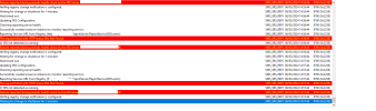

You are correct. This morning, I noticed a few errors in the status message viewer, but they were automatically fixed after restarting the server, and the service is now running. However, the srsrp.log is showing the error: 'The request failed with HTTP status 404: Not Found
After following the steps below, it seems that the issue 'The request failed with HTTP status 404: Not Found' has been resolved,
Option 1: change ReportServerUri parameter at registry key HKEY_LOCAL_MACHINE\SOFTWARE\Microsoft\SMS\SRSRP
Like this: http://server:**/ReportServer
Option 2: remove/install ConfigMgr reporting service point
but another issue has appeared in srsrp.log,
If anyone experience with this error, please let me know
The screenshot clearly shows that the URL is 404. Have you check the URL? have you check the health of SSRS? What troubleshooting have you done?
After changing the virtual service account to a domain account, it started working as expected,
