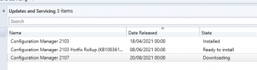

was wondering if anybody else is experiencing issues downloading v2107 in config manager?
in updates and servicing the downloading for v2107 gets stuck in downloading state and doesnt finish so i cannot do a prerequisite check.

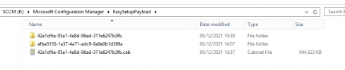

the EasySetupPayload folder has the cab file and it looks like it downloads it without any issues.
the logs show that its extracting the cab file.

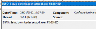

3. run the following to download the files needed. you can open open the log file to monitor the status.
setupdl.exe /RedistUrl https://go.microsoft.com/fwlink/?LinkID=2184007 /LnManifestUrl https://go.microsoft.com/fwlink/?LinkId=2179667 /RedistVersion 202111 /NoUI "C:\temp\redist" >> "C:\redist.log"
once download finishes the log file will contain.

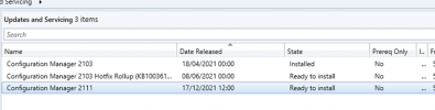

once done, refresh the updates console and v2111 should be ready to install

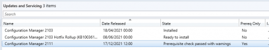

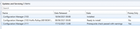

as mentioned my pre-req check is now completed.
