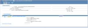

But Error trace log show the below
When you expand the trace, it shows:

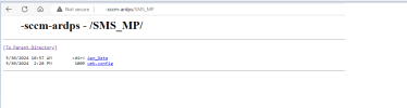

The MP verification URL show the below
Both
And
show the below page (ignore the URL in the screen shot)
I have double checked permissions across the SMC_CCM folder, its subfolder and files and went as far as giving every principal, including 'Everyone' and 'IIS_IUSRS' full control.
1717590938094-png.6250
