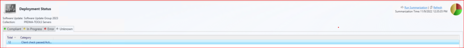

Hi there,
My clients are getting stuck in Unknown state with "Client check passed/Active".
The WUAhandler log has the following log:
WUAHandler: OnSearchComplete - Failed to end search job. Error = 0x80244007.
Scan failed with error = 0x80244007
The weird thing is that one of the client is on compliant state among 12 client with in the same deployment and other 11 are on the unknown state.
Can someone guide me further to investigate it.
Thanks in advance.
This is weird. All of a sudden all clients back to unknown state. after everything was working fine as expected.
Will update more.

After almost 24 hr and doing Evaluate software deployment / download computer policy on the asset group, the deployment is as follows among 12 clients:
in progress:
pending system restart = 2 clients
successfully installed = 1 client
Error:
Error code 0x0000000 = 7 client
Error code 0X8000FFFF = 2 client
And not they are moving no where, I tried to do evaluate software deployment couple of times to trigger the deployment.

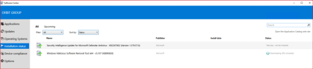

Other thing I noticed on the clients when I logged into them.
All clients were at this state:
After I clicked on it it would give me the option to restart the computer:
And when reboot right now selected, it would open the software center and start downloading the additional updates.
Any idea what made it got stuck in that state?
