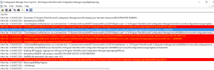

Hi, I have just recently updated to Configuration Manager 2107 and also installed the recent hotfix. All devices are now showing a Device Online Status of "offline" and the icon is greyed out with an "X". I had the same issue when updating to 2103 and updated the regsrvcs.exe.config and installutil.exe.config files which then allowed it to work. However I cannot reapply the same fix as it was already done in the past and still reflects in the files. The only change to the server between 2103 and 2107 is installing the .net 4.8 prerequisite. Any help would be much appreciated!
Below is the error from the bgpsetup.log.
