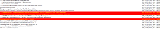

I cannot get the SCCM client to install on any endpoints via the SCCM client push feature. (New install of SCCM server)
CCM.log entry from SCCM server:
======>Begin Processing request: "2097152081", machine name: "computer09" SMS_CLIENT_CONFIG_MANAGER 9/19/2016 3:28:15 PM 8424 (0x20E8)
Execute query exec [sp_IsMPAvailable] N'MD1' SMS_CLIENT_CONFIG_MANAGER 9/19/2016 3:28:15 PM 8424 (0x20E8)
---> Trying the 'best-shot' account which worked for previous CCRs (index = 0x0) SMS_CLIENT_CONFIG_MANAGER 9/19/2016 3:28:15 PM 8424 (0x20E8)
---> Attempting to connect to administrative share '\\computer09.mydomain.local\admin$' using account 'mydomain\sccmadmin' SMS_CLIENT_CONFIG_MANAGER 9/19/2016 3:28:15 PM 8424 (0x20E8)
---> The 'best-shot' account has now succeeded 21 times and failed 0 times. SMS_CLIENT_CONFIG_MANAGER 9/19/2016 3:28:15 PM 8424 (0x20E8)
---> Connected to administrative share on machine computer09.mydomain.local using account 'mydomain\sccmadmin' SMS_CLIENT_CONFIG_MANAGER 9/19/2016 3:28:15 PM 8424 (0x20E8)
---> Attempting to make IPC connection to share <\\computer09.mydomain.local\IPC$> SMS_CLIENT_CONFIG_MANAGER 9/19/2016 3:28:15 PM 8424 (0x20E8)
---> Searching for SMSClientInstall.* under '\\computer09.mydomain.local\admin$\' SMS_CLIENT_CONFIG_MANAGER 9/19/2016 3:28:15 PM 8424 (0x20E8)
---> Unable to connect to WMI on remote machine "computer09.mydomain.local", error = 0x80070005. SMS_CLIENT_CONFIG_MANAGER 9/19/2016 3:28:15 PM 8424 (0x20E8)
---> Unable to connect to WMI on remote machine "computer09", error = 0x80070005. SMS_CLIENT_CONFIG_MANAGER 9/19/2016 3:28:15 PM 8424 (0x20E8)
---> Deleting SMS Client Install Lock File '\\computer09.mydomain.local\admin$\SMSClientInstall.MD1' SMS_CLIENT_CONFIG_MANAGER 9/19/2016 3:28:15 PM 8424 (0x20E8)
Execute query exec [sp_CP_SetLastErrorCode] 2097152081, -2147024891 SMS_CLIENT_CONFIG_MANAGER 9/19/2016 3:28:15 PM 8424 (0x20E8)
Stored request "2097152081", machine name "computer09", in queue "Retry". SMS_CLIENT_CONFIG_MANAGER 9/19/2016 3:28:15 PM 8424 (0x20E8)
Execute query exec [sp_CP_SetPushRequestMachineStatus] 2097152081, 2 SMS_CLIENT_CONFIG_MANAGER 9/19/2016 3:28:15 PM 8424 (0x20E8)
Execute query exec [sp_CP_SetLatest] 2097152081, N'09/19/2016 21:28:15', 259 SMS_CLIENT_CONFIG_MANAGER 9/19/2016 3:28:15 PM 8424 (0x20E8)
<======End request: "2097152081", machine name: "computer09".
-I have added the domain user to the local administrator group even though I don't think it's necessary as the user is a domain admin.
-I have also added firewall rules to firewall on both ends that should allow WRM, WMI and file sharing which I also don't thing is necessary as the firewalls are off on both machines. (And MS tech support told me it DID matter so they requested I add the rules anyway...)
-My network admins tell me there are NO ports being blocked at the network level.
-wbemtest tool confirms that the same error message comes up when trying to connect to the root of the endpoint from the server.
What am I missing?
Any help would be awesome. Thanks in advance!
Steve
Can you connect to or access \\computer09.mydomain.local\admin$\ from your SCCM server ?. If the client push account is member of domain admins then you need not add it to the local admin group. I hope you have turned off the firewall and not stopped the firewall service from services console ?. If you have allowed the required ports in firewall then you may turn it on. Have you checked if there is any security software like antivirus that might be blocking this ?. If you still face the issue then you could download WMIDiag tool and see what's causing the issue - https://www.microsoft.com/en-us/download/details.aspx?id=7684
After check i found the solution "reset computer account and rejoin the domain"
then delete the computer device from SCCM Console and rediscover.
