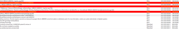

i managed to get my hands on the smsts.log file from the vm that im working on and at the end of the log i can see the following.
Content location request for UBB00003:19 failed. (Code 0x80040102) TSPxe 18/01/2023 09:59:06 1444 (0x05A4)
hr, HRESULT=80040102 (..\tspolicy.cpp,2924) TSPxe 18/01/2023 09:59:06 1444 (0x05A4)
Failed to resolve PackageID=UBB00003 TSPxe 18/01/2023 09:59:06 1444 (0x05A4)
(*iTSReference)->Resolve( pTSPolicyManager, dwResolveFlags ), HRESULT=80040102 (..\tspolicy.cpp,3798) TSPxe 18/01/2023 09:59:06 1444 (0x05A4)
m_pSelectedTaskSequence->Resolve( m_pPolicyManager, TS::Policy::TaskSequence::ResolvePolicy | TS::Policy::TaskSequence::ResolveSource, fpCallbackProc, pv, hCancelEvent), HRESULT=80040102 (tsmediawizardcontrol.cpp,1603) TSPxe 18/01/2023 09:59:06 1444 (0x05A4)
Failed to resolve selected task sequence dependencies. Code(0x80040102) TSPxe 18/01/2023 09:59:06 1444 (0x05A4)
hrReturn, HRESULT=80040102 (tsmediaresolveprogresspage.cpp,445) TSPxe 18/01/2023 09:59:06 1444 (0x05A4)
ThreadToResolveAndExecuteTaskSequence failed. Code(0x80040102) TSPxe 18/01/2023 09:59:06 1444 (0x05A4)
ThreadToResolveAndExecuteTaskSequence returned code 0x80040102 TSPxe 18/01/2023 09:59:06 1240 (0x04D8)
Setting wizard error: This task sequence cannot be run because the program files for UBB00003 cannot be located on a distribution point. For more information, contact your system administrator or helpdesk operator. TSPxe 18/01/2023 09:59:06 1240 (0x04D8)
ResolveProgressPage::OnWizardNext() TSPxe 18/01/2023 09:59:06 1240 (0x04D8)
Activating Finish Page. TSPxe 18/01/2023 09:59:06 1240 (0x04D8)
