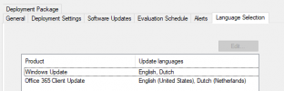

I have created an ADR with below settings:
(I added Dutch just now to see if this makes a difference)
This ADR is deployed to a few device collections:

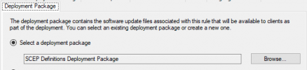

Below settings are for the Deployment Package:

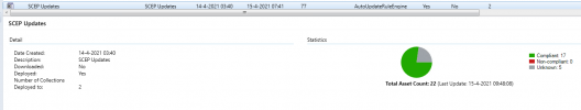

A Software Update Group named SCEP Updates has been created by above actions:
But every time I look if there are new definition updates I seem to have to add them to the Software Update Group manually (I thought ADR would do that), and as shown in the screenshot below the clients have the status Not Required:

The Software Update Group shows most of the clients as Compliant, so what is the truth?

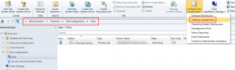

Open Software Update Point settings:
For this to work you need at least Definition Updates:
Under Products we selected:
We are syncing updates every hour (note that this only syncs the updates, it doesn't download updates):
Also make sure you selected the correct languages in the Languages tab.
