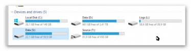

About the Space:
I have 1 Primary Site and 9 secondary sites + about 20 Distribution Points in other locations
On the Primary Site is the WSUS installed, but DP and MP are on a separate Server. 1642660923800.png

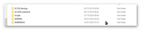

I don't think Data (D:) needs so much space. I enabled Data Deduplication so its shows that 2.8 TB are used, without the Data Deduplication the whole D Drive would be 9 TB. So I searched if there are files on the PS that are not in use or he couldn't delete. I found the PCK Files that are created in 2020. But before I delete any files I always checking on forums about it but I couldn't really get the informations what use the SMSPKG folder has.
As I could read, the folder should have something do to with the sync/replication between the Servers. But I am not sure, so can you bring some light in the dark ?

Deleting anything out of the inboxes is generally a bad idea. Particularly without reviewing the log files.
smspkg folder stores package sources that are sent to other sites/dps. If you delete them they will get recreated if they are needed again. Which will slow down the deployment time.
