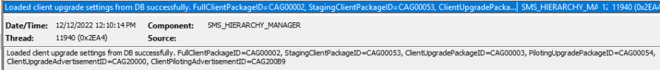

This is the Highlights i found in the hman.log that i think are relevant to the issue (full log also attached to the post) -
Loaded client upgrade settings from DB successfully. FullClientPackageID=CAG00002, StagingClientPackageID=CAG00053, ClientUpgradePackageID=CAG00003, PilotingUpgradePackageID=CAG00054, ClientUpgradeAdvertisementID=CAG20000, ClientPilotingAdvertisementID=CAG200B9
ERROR: Failed to get the package object for package CAG00054.
ERROR: Failed to update package content for CAG00054.
Handle client piloting configuration changes
Client piloting enable state = 1
Error: couldn't find package program from id 'CAG00054'
WARN: Detected the client upgrade program doesn't exists. Will recreate it and the offer.
WARN: Detected the piloting client upgrade package (ID=CAG00054) doesn't exists. Will recreate it and the program/offer.
INFO: Recreating missing objects related to client upgrade.
INFO: Successfully created client upgrade program with command line ccmsetup.exe /AutoUpgrade.
INFO: Successfully created client piloting upgrade package (ID=CAG0296B).
Warn: couldn't find the client piloting offer from offer ID 'CAG200B9'.
So this is where i need your help ,it looks like im missing the piloting package, and this is was it stuck on the post install stage.
