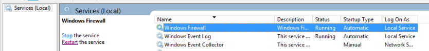

Also, is the Windows Firewall service started & running on the target computer showing a grey question mark status? Simple stuff like doing a basic audit on Windows services running on the target computer, if the Windows Firewall service isn't running on the target computer, you're probably going to have issues connecting on the required SCCM ports.
Target computer:
SCCM Mgmt Point:
