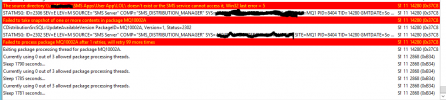

In the distmgr i only found this:
STATMSG: ID=2302 SEV=E LEV=M SOURCE="SMS Server" COMP="SMS_DISTRIBUTION_MANAGER" SYS="MYSCCMSERVR" SITE=MQ1 PID=2352 TID=7748 GMTDATE=Mi Apr 07 20:42:53.249 2021 ISTR0="Adobe Reader DC" ISTR1="MQ100025" ISTR2="" ISTR3="" ISTR4="" ISTR5="" ISTR6="" ISTR7="" ISTR8="" ISTR9="" NUMATTRS=1 AID0=400 AVAL0="MQ100025" $$<SMS_DISTRIBUTION_MANAGER><04-07-2021 21:42:53.249-60><thread=7748 (0x1E44)>
~Failed to process package MQ100025 after 0 retries, will retry 100 more times $$<SMS_DISTRIBUTION_MANAGER><04-07-2021 21:42:53.710-60><thread=7748 (0x1E44)>
~Exiting package processing thread for package MQ100025. $$<SMS_DISTRIBUTION_MANAGER><04-07-2021 21:42:53.713-60><thread=7748 (0x1E44)>
~Currently using 0 out of 3 allowed package processing threads. $$<SMS_DISTRIBUTION_MANAGER><04-07-2021 21:42:57.407-60><thread=7756 (0x1E4C)>
~Sleep 1826 seconds... $$<SMS_DISTRIBUTION_MANAGER><04-07-2021 21:42:57.408-60><thread=7756 (0x1E4C)>
~Currently using 0 out of 3 allowed package processing threads. $$<SMS_DISTRIBUTION_MANAGER><04-07-2021 21:43:01.931-60><thread=7756 (0x1E4C)>
~Sleep 1822 seconds... $$<SMS_DISTRIBUTION_MANAGER><04-07-2021 21:43:01.933-60><thread=7756 (0x1E4C)>
~Currently using 0 out of 3 allowed package processing threads. $$<SMS_DISTRIBUTION_MANAGER><04-07-2021 21:43:06.459-60><thread=7756 (0x1E4C)>
~Sleep 1817 seconds... $$<SMS_DISTRIBUTION_MANAGER><04-07-2021 21:43:06.643-60><thread=7756 (0x1E4C)>

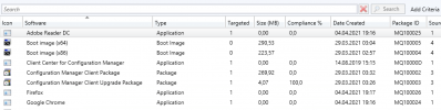

Thats how the one of the Package looks like:
Following the Deployments Types properties:
What i see is that also the size is not recognize of the package, not sure if this is an issue or not.

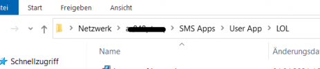

Hello Prajwal, first of all thank you for your reply. I tried the sugestion created a Collection with one machine. No sucess. Error is still the same. Its stated that the source directory is not accesible.
What i did so far:
Removed the DP and MP role. Add them back. Changed location for the Site Server Folders. Since then also the ccmsetup was working fine on the clients. All of the are up to date now.
Removed all packages again and created new collections. At the end. Issue is still the same. Also changed directory etc. No resolution so far. Anyone an idea.
But the package is accesible for all clients, as also form the site server.
What is strange is that the ccm setup appears in Software Center.
Hello all, to share the solution. I had System missing in Advance sharing from the apps folder. After adding it the packages went trough. Thank you all for your help.
