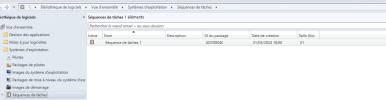

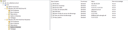

following the preparation of the system deployment with scp 2309, I installed and configured the wds role for pxe, add a wim image with the latest ISO of windows 10 2202 H2, distribute the contents,in the dcp part, I added the options (60,66 and 67 ) .now when I test the boot in a machine by F12 it does not pass
attached are screenshots of the configuration

Hi Prajwal,
for the dhcp proxy, do I need to add a new option in the DHCP settings or just a service to allow in the dhcp server and SCCM?
Cordially
When I activate the 060 PXE CLient in the extension , I receive the message from port 4011
Cordially

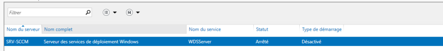

hi,
I've noticed that the WDS service is not running on the SCCM server. Is this normal?

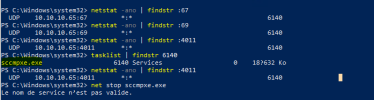

Hi Prajwal,
I notice that sccmpxe also uses the same ports 67,69 and 4011 as WDS, so since these ports are reserved by SCCMPXE, WDS can't stay running.

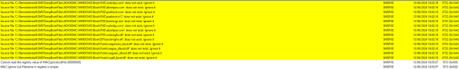

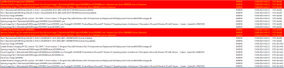

hello,
please find attached the captures of the detected errors
Cordially
