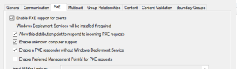

Due to security reasons, we have moved all our servers to a different VLAN, while clients are in another VLAN. There have been no issues with package deployments and patching from SCCM to all endpoints. However, when attempting PXE boot (both legacy and UEFI), I did not receive an IP address from the DHCP server, and there is limited information available in the SMSPXE.log,
PXE config:
We do not have a network expert in our company. From my understanding, there seems to be no handshake between the client and DHCP server, and no communication between DHCP and the SCCM server, likely due to something missing in the VLAN setup. Could you please help me understand the prerequisites needed to troubleshoot and resolve this issue? Do we have any workarounds available to make it functional for now?
