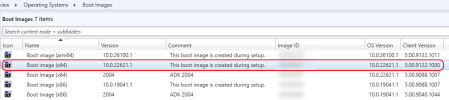

One thing I noticed on the main console is my boot images don't look like they updated. Before I did the 2509 upgrade, I ran the ADK Dec 2024 update (ADK 10.1.26100.2454) including the WinPE add-on. But none of the existing boot images show a version newer than 10.0.22621.1 for the boot image version, and 5.00.9122.1000 for the client version.
