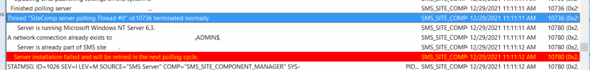

I am trying to install a MP on a remote DP server, the site component manager detected the component is exited, but the MP do not be existed
I copied the components message below from the sccm component status , do you have any idea ?
Site Component Manager detected that site system "***********" is currently in use by ConfigMgr site ***.
Possible cause: You accidentally configured this site system as part of this site and as part of site ***.
Solution: Remove this site system from the list of site systems for this site or for site ***.
Site Component Manager failed to configure site system "********" to receive Configuration Manager Server Components.
Solution: Review the previous status messages to determine the exact reason for the failure.
Site Component Manager cannot install any Configuration Manager Server Components on this site system until the site system is configured successfully.
Site Component Manager will automatically retry this operation in 60 minutes.
To force Site Component Manager to immediately retry this operation, stop and restart Site Component Manager using the Configuration Manager Service Manager.
Site Component Manager detected that this component should be installed on this site system.
Site Component Manager will attempt to install the component every 60 minutes until the installation succeeds.
from sitecomp log , there is below error
