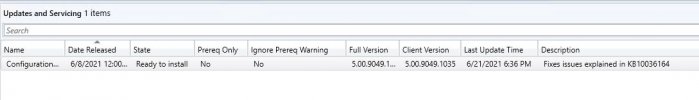

Also now when I checked available hotfixes, only available was KB10036164 and it is asking me to create Azurecloud intune account. which I don't want to. can I skip this installation of hotfix. Please advice
