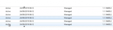

New build devices are stuck on the latest definitions of 24/09/2019 and the Endpoint Engine version remains on 1.1.1.16400.2:

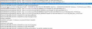

The client knows which updates are missing and need installing from the SUG based on the UpdatesStore.log:
Despite this though nothing is cached and nothing gets installed.

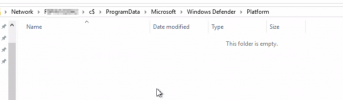

One difference we noticed on new devices that fail to download SCEP updates are missing content within the C:\ProgramData\Microsoft\Windows Defender\Platform
Non-working device which fails to download definitions from configuration manager:
Working device with up to date definitions from configuration manager:

I can see differences in the DataTransferService.log between working and non-working devices, on the working device I see references to the required definitions updates and requests to download that content with a complete notification.
DataTransferService.log (Working Device):
If I run a software update scan on a non-working device I can see a new DTSJob gets created but there is never any reference to the URLs for the required EP definitions so they seem to be evaluating this differently and I have no idea why.
DataTransferService.log (Non Working Device)
