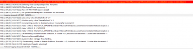

This is what I see as of this morning in the mpMSI.log:

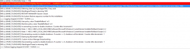

This is what I see in the mpMSI.log.LastError:
