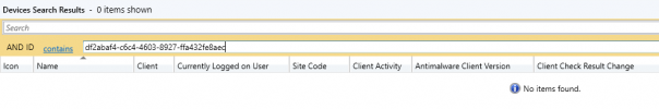

When I search the first GUID, I end up with an Unknown computer:
When I search the second GUID, nothing is found:
