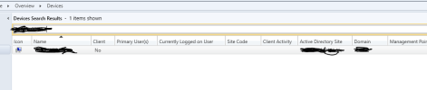

Hi everyone,
I ve been practicing with SCCM for about a year now and my experience is not that great but i try to keep myself up to date.
There is an SCCM site on DomainA which includes site server,an extra MP and a new MP2 which resides on the new location and will serve the clients there to avoid heavy network load since they are on a different location.
Communications between locations is being set up to work over IPSEC
I manage to deploy ccmsetup on some computers with exit code 0. My only parameters were mp:'newMP' /SMSSITECODE and /source since i copied all the necessary files on each client so nothing fancy.
Communication is being set up by the network team to work over IPSEC and appropriate ports have been opened upon request.
On that new location i first deployed 2 new Domain controllers that i use as DNS servers, and then that new MP. I managed to establish communication with my main site without any issues and the new MP is shown as healthy.
I configured DNS with the proper reverse lookup zones to avoid having any DNS issues with the domain and the clients.
I notice that whike ccmsetup installation completes without any issues,the site discovery and client registration is not working at all.
LocationServices.log shows:
No Location Reply received from MPxxxxx
ClientIDManagerStartUp.log shows:
I have checked ports 80,443 with the new MP and they are open. The only port that fails is port 1432 from the new MP to the DB server for which i have made a ticket to the network team to open it.
The computers are using a DHCP server(not sure why and who configured it like that) which is member of another domain (DomainB) that resides on the same location. DomainB happens to have a two way trust with DomainA.
On site server i have configured a boundary group which points to the new MP as site system server.The group includes both AD site and IP address range of the target computers.
Configuration Manager on the client shows Certificate:none in the General tab.
My SCCM site properties are as follows:
Any other idea what might be the cause, clients fail to register properly and also discover location?
They show on console but the client installed status is No
Thank you in advance for your time
