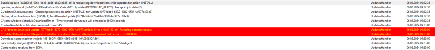

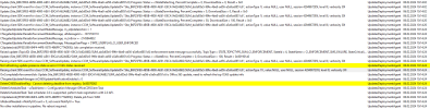

The Office update is visible in the Software Centre and aborts shortly after starting with the error 0x801901A0. This has already been recreated and the error still remains.
UpdatesStore.log
UpdatesHandler.log
We have installed 6 languages and these are also selected in the update process. I can not find any Errors in the CAS.Log
UpdatesDeployment.log
