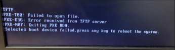

I have facing an issue with PXE booting. While trying to boot through PXE it shows PXE--T00: Failed to Open File (Also getting PXE-E36,PXE-M0F), but after delete the target machine from SCCM Administration console -> Assets and Compliance -> Devices, I can able to boot with the PXE service. Is it any solution for avoid the manual device deletion from SCCM?

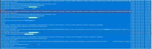

please find the SMSPXE log file. After getting this error I searched for this Mac address in the SCCM management console ->Devices -> Search with that Mac address and delete that system. After this step I rebooted the same workstation, in that time it was perfectly booted with PXE.
Can you please give me a solution to avoid the device deletion every time?
