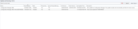

I upgraded SCCM version to 2403 after receiving the end of support notice. It has been 3 days and the workstations on the system still cannot update to the new version and are all offline. What should I do to speed up the upgrade process to the workstations ??
Thanks for the support
Thanks for the screenshot. You have set the automatic client upgrade to occur within 7 days. Have you waited for 7 days?

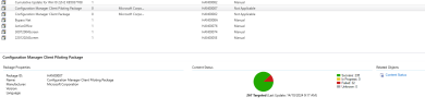

i checked the bgb log file but everything seems to be wrong
1728894029776.pngClient Log
Can I speed this up by changing the time from 7 days to 1 day. Does the change have any effect now?
