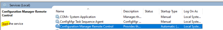

I compared with working machine. I found the below service is started automatically where in to the working machine. But the problematic machine the service wont start automtically.
