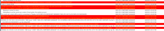

Need assistance with this please as my Primary Server is not able to connect to DMZ Server -
Error:
Collected the NetMon:
69680 2025-04-15 23:39:05.038570 10.125.12.28 10.13.7.25 SMB2 Session Setup Request, NTLMSSP_NEGOTIATE
69681 2025-04-15 23:39:05.038913 10.13.7.25 10.125.12.28 SMB2 Session Setup Response, Error: STATUS_MORE_PROCESSING_REQUIRED, NTLMSSP_CHALLENGE
69733 2025-04-15 23:39:05.078858 10.125.12.28 10.13.7.25 SMB2 Session Setup Request, NTLMSSP_AUTH, User: CORP\SCCMPRI02$
69745 2025-04-15 23:39:05.079886 10.13.7.25 10.125.12.28 SMB2 Session Setup Response, Error: STATUS_LOGON_FAILURE
Testing connectivity to this server ...NetBIOS failed - 1365: ClientRealmName is '' for user 'UCSCSCOM\DCNOO$MCM' because connecting to server '\UCSCSCOM.UCSCSCOM.NET'.Unable to disable NTLM.Control path test failed for "\\Display=\\UCSCSCOM.UCSCSCOM.NET\SMS_SITE-NV2\SMS_SITE=NV2". (UCSCSCOM.UCSCSCOM.NET).Failed to make a network connection to \\UCSCSCOM.UCSCSCOM.NET\ADMIN$\SMS_SITE=).Retrying to connect to server.Attempting to use the current user context of local system, the machine account.The current user context will be used for connecting to "\\Display=\\UCSCSCOM.UCSCSCOM.NET\SMS_SITE-NV2\SMS_SITE=NV2" 1 (UCSCSCOM.UCSCSCOM.NET).Failed to make a network connection to \\UCSCSCOM.UCSCSCOM.NET\ADMIN$\SMS_SITE=).ERROR: Failed to access server "\\UCSCSCOM.UCSCSCOM.NET\". probably because the machine is down, the network is down, or the Site System Installation account is misconfigured. (CWin32Exception: 0x80070005)STATMSG: ID=1037 SEV=E LEV=A SOURCE="SMS Server" COMP="SMS_SITE_COMPONENT_MANAGER" SYS=SCCMPRV02.corpscholasticlocal.local SITE=NV2 PID=3372 TID=3492 GMTDATE=Tue Apr 01, ... SMS_SITE_COMPONENT_MANAGER.\\UCSCSCOM.UCSCSCOM.NET is not the Default MP.Cannot access HKEY_LOCAL_MACHINE\SOFTWARE\Microsoft\SMS\registry keys on server \\UCSCSCOM.UCSCSCOM.NET. The operating system reported error 5: Access is denied.STATMSG: ID=3739 SEV=E LEV=M SOURCE="SMS Server" COMP="SMS_SITE_COMPONENT_MANAGER" SYS=SCCMPRV02.corpscholasticlocal.local SITE=NV2 PID=3372 TID=3492 GMTDATE=Tue Apr 08, ... SMS_SITE_COMPONENT_MANAGERCannot access HKEY_LOCAL_MACHINE\SOFTWARE\Microsoft\SMS\MP\inventory registry keys on server \\UCSCSCOM.UCSCSCOM.NET. The operating system reported error 5: Access is denied.STATMSG: ID=3739 SEV=E LEV=M SOURCE="SMS Server" COMP="SMS_SITE_COMPONENT_MANAGER" SYS=SCCMPRV02.corpscholasticlocal.local SITE=NV2 PID=3372 TID=3492 GMTDATE=Tue Apr 08, ... SMS_SITE_COMPONENT_MANAGER

I see the error says.." HKEY_LOCAL_MACHINE\SOFTWARE\Microsoft\SMS\MP\inventory ... error denied.." suggests MP ( Management point does not have correct permissions.
Check the Site Server's Computer Account Permissions
You need to make sure that the computer account of the site server (SCCMPRV02) has local admin rights on the Management Point server (UCSCSCOM.UCSCSCOM.NET).
Step 1
To do this:
On \\UCSCSCOM.UCSCSCOM.NET, open Computer Management > Local Users and Groups > Groups.
Open the Administrators group, add the SCCM site server’s computer account, example CORPSCHOLASTICLOCAL\SCCMPRV02$.
Make sure it’s the computer account, with the $ at the end.
Step 2
Restart SMS_SITE_COMPONENT_MANAGER Service
Once the permissions are fixed then either restart the SMS_SITE_COMPONENT_MANAGER service, or just restart the SCCM server to reinitialize everything.
You can also force a re-install of the MP role from the console if needed.
See if that fixes it
