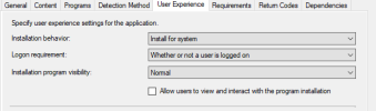

Guys,
I am at my wits end here, can anyone please tell me what is going on here?
Our TS is failing on the same apps each time, currently failing to install office. Have re-added office fresh, verified install CMD is good, new task sequence, the lot.
From last part of smsts.log
<![LOG[Shutdown complete.]LOG]!><time="16:45:25.984-600" date="03-13-2023" component="TSProgressUI.exe" context="" type="1" thread="1920" file="winmain.cpp:515">
<![LOG[Execution engine result code: Reboot (2)]LOG]!><time="16:45:25.984-600" date="03-13-2023" component="TSManager" context="" type="2" thread="1860" file="tsmanager.cpp:1301">
<![LOG[Process completed with exit code 2147945410]LOG]!><time="16:45:26.000-600" date="03-13-2023" component="TSMBootstrap" context="" type="0" thread="1828" file="CommandLine.cpp:1161">
<![LOG[Task Sequence Manager returned code 0x80070BC2]LOG]!><time="16:45:26.000-600" date="03-13-2023" component="TSMBootstrap" context="" type="1" thread="1828" file="tsmediawizardcontrol.cpp:2303">
<![LOG[Setting reboot required flag.]LOG]!><time="16:45:26.000-600" date="03-13-2023" component="TSMBootstrap" context="" type="0" thread="1828" file="tsmediawizardcontrol.cpp:2308">
<![LOG[ThreadToResolveAndExecuteTaskSequence returned code 0x00000000]LOG]!><time="16:45:26.000-600" date="03-13-2023" component="TSMBootstrap" context="" type="1" thread="1604" file="tsmediaresolveprogresspage.cpp:221">
<![LOG[ResolveProgressPage::OnWizardNext()]LOG]!><time="16:45:26.000-600" date="03-13-2023" component="TSMBootstrap" context="" type="0" thread="1604" file="tsmediaresolveprogresspage.cpp:113">
<![LOG[Activating Finish Page.]LOG]!><time="16:45:26.000-600" date="03-13-2023" component="TSMBootstrap" context="" type="0" thread="1604" file="tsmediafinishpage.cpp:107">
<![LOG[Execution complete.]LOG]!><time="16:45:26.390-600" date="03-13-2023" component="TSBootShell" context="" type="1" thread="1044" file="bootshell.cpp:845">
<![LOG[hMap != 0, HRESULT=80070002 (K:\dbs\sh\cmgm\1125_114522\cmd\t\src\Framework\TSCore\environmentscope.cpp,495)]LOG]!><time="16:45:26.406-600" date="03-13-2023" component="TSBootShell" context="" type="0" thread="1044" file="environmentscope.cpp:495">
<![LOG[m_pGlobalScope->open(), HRESULT=80070002 (K:\dbs\sh\cmgm\1125_114522\cmd\t\src\Framework\TSCore\environmentlib.cpp,335)]LOG]!><time="16:45:26.406-600" date="03-13-2023" component="TSBootShell" context="" type="0" thread="1044" file="environmentlib.cpp:335">
<![LOG[this->open(), HRESULT=80070002 (K:\dbs\sh\cmgm\1125_114522\cmd\t\src\Framework\TSCore\environmentlib.cpp,561)]LOG]!><time="16:45:26.406-600" date="03-13-2023" component="TSBootShell" context="" type="0" thread="1044" file="environmentlib.cpp:561">
<![LOG[::RegQueryValueExW(hSubKey, szReg, NULL, NULL, NULL, &dwSize), HRESULT=80070002 (K:\dbs\sh\cmgm\1125_114522\cmd\t\src\Framework\TSCore\utils.cpp,691)]LOG]!><time="16:45:26.406-600" date="03-13-2023" component="TSBootShell" context="" type="0" thread="1044" file="utils.cpp:691">
<![LOG[RegQueryValueExW is unsuccessful for Software\Microsoft\SMS\Task Sequence, SMSTSEndProgram]LOG]!><time="16:45:26.406-600" date="03-13-2023" component="TSBootShell" context="" type="2" thread="1044" file="utils.cpp:691">
<![LOG[GetTsRegValue() is unsuccessful. 0x80070002.]LOG]!><time="16:45:26.406-600" date="03-13-2023" component="TSBootShell" context="" type="2" thread="1044" file="utils.cpp:722">
<![LOG[End program: ]LOG]!><time="16:45:26.406-600" date="03-13-2023" component="TSBootShell" context="" type="1" thread="1044" file="bootshell.cpp:877">
<![LOG[Finalizing logging from process 364]LOG]!><time="16:45:26.406-600" date="03-13-2023" component="TSBootShell" context="" type="1" thread="1044" file="tslogging.cpp:2107">
<![LOG[Finalizing logs to root of first available drive]LOG]!><time="16:45:26.406-600" date="03-13-2023" component="TSBootShell" context="" type="1" thread="1044" file="tslogging.cpp:1949">
<![LOG[Successfully finalized logs to C:\SMSTSLog]LOG]!><time="16:45:26.419-600" date="03-13-2023" component="TSBootShell" context="" type="1" thread="1044" file="tslogging.cpp:2006">
<![LOG[Cleaning up task sequencing logging configuration.]LOG]!><time="16:45:26.419-600" date="03-13-2023" component="TSBootShell" context="" type="0" thread="1044" file="tslogging.cpp:904">
<![LOG[TS::Environment::SharedEnvironment.isInitialized() == true, HRESULT=80004005 (K:\dbs\sh\cmgm\1125_114522\cmd\t\src\Framework\TSCore\tslogging.cpp,694)]LOG]!><time="16:45:26.419-600" date="03-13-2023" component="TSBootShell" context="" type="0" thread="1044" file="tslogging.cpp:694">
<![LOG[TS environment is not initialized]LOG]!><time="16:45:26.419-600" date="03-13-2023" component="TSBootShell" context="" type="3" thread="1044" file="tslogging.cpp:694">
