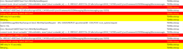

Whenever i try to image a device task sequence is getting stuck at "retrieving policy screen" and then fails.
I have checked the SMSTS logs and it fails to connect the socket.
The error 0x80072EE2 in this case is not related to Configuration Manager; rather it has to do with the network policies and security devices.
