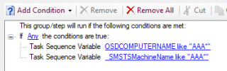

Am hoping someone can help, after much Googling and testing on my SCCM lab I have setup I have been unsuccessful in this.
I have created a group at the end of my task sequence called AAA Site Apps and added a few applications to be installed, I have tried to add a few conditions to this based on the computer name for example;
I prompt for the OSDCOMPUTERNAME for all unknown computers...
I have also tried the AAA% and the %AAA% on the second one.
The reason for this is the first three letters will be a side code.
So far none have worked even though it seems they should when reading up on this.
Thanks for your support.
Karl

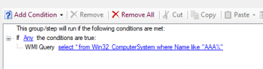

The query based on ComputerSystem name seems ok. You should be able to click on it and Test it to make sure it's working. Just try it on your computer with the first few digits of your computer name in place of the AAA.
