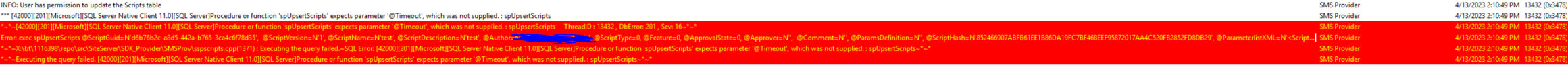

This week my MECM started to give us this error. I uploaded a screenshot of the logs. I can't find an obvious error to begin troubleshooting from the logs. ScriptSMSError.PNGScriptError.PNG
This week my MECM started to give us this error. I uploaded a screenshot of the logs. I can't find an obvious error to begin troubleshooting from the logs. View attachment 5167View attachment 5168
it complains about the script timeout. whats the time out of your script? check the properties and it should be there. the default is 1800 seconds if you havent changed it
I'm having trouble finding the time out for the script. It's not in the properties, and I should've clarified but this issue is in regards to creating the script, not running a script. We're still able to run them.
I solved this problem. Once we updated to 2211 that Script timeout field was available. In the previous version we had (2203) it was not there. Thank you for your help.
