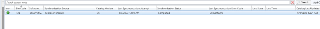

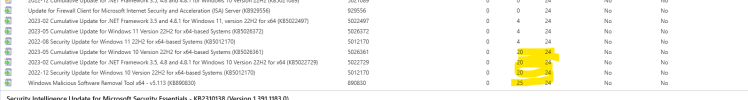

I recently installed a new sccm with all the necessary prerequisites wsus is ok the settings for downloads are ok the client settings are ok however no workstation has required updates for three months. Do you have any suggestions ?

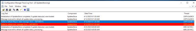

From log under a pc machine j can see these error :
From :
UpdatesStore.log
UpdatesHandler.log
WUAHandler.log
LocationServices.log
Boundarys group seem to be the pb ...
