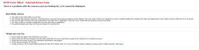

Here is another error that provides more insight.. permissions, corruption in app pool?...banging my head around this problem..

Had a similar problem ages ago, if i recall correctly it was a permissions issue on the physical folders or in .net folders, not 100% sure but i will have a look back at my notes
yea was checking the path folders going to the app pool and they looked correct but yea if you find anything in your notes be greatly appreciative!
