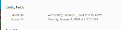

Failed in GetCertificate(...): 0x87d00281 - I think it's related to your expired certificate. You may try to renew the certificate on your client and MP to see if it can fix the issue.
