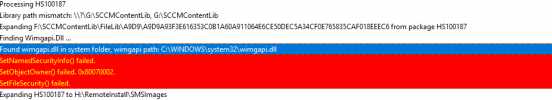

After upgrading the server to SQL 2019 and to SCCM 2107 PXE has stopped working and giving the error "the PXE server processed a request from a client of architecture x64uefi. However there were no boot images installed for this architecture."
ADK version 10.0.22000.0
I have gone through uninstalled and reinstalled the latest version of ADK and ADK preinstallation environment, removed the check mark from SCCM PXE made sure WDS was uninstalled. rebooted. Went into SCCM and marked enabled PXE support, allow this distribution point to respond to incoming PXE request, Enable Unknown computer support. Respond to PXE requests on all network interfaces. Made sure WDS installed, no errors and rebooted.
Went through and updated the boot images in SCCM and reloaded this image with the current Windows PE version from Windows ADK, made sure Network drivers were added.
but still getting the error.
in the distmgtr.log
in the distmgtr.log
