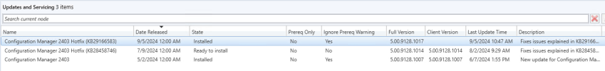

I didnt install hotfix before this (i mean on KB28458746). Can i just install that hotfix, will i have some problem if i do it?
