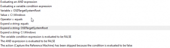

When attempting to capture a manually sysprep'd image, I receive....

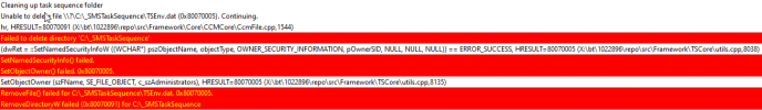

and a little further down the SMSTS (even though the only step enabled in TS was to capture and it already failed above)....
If I create a Build & Capture default TS, it will deploy and capture successfully (no image modifications, just a base win10 or win11 install, then captured)....
-Machine is not domain joined
-OSDTargetSystemRoot has been set to "C:\Windows" (see diskpart image above for confirmation of "C:\" and not "D:\". "D:\" was tried however for testing. Made no difference, messages were the same in SMSTS)
Any help or insight / suggestions are greatly appreciated. Thank you!
