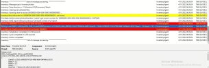

I'm having trouble collecting hardware inventory on PCs, but this is only happening on connected machines at Secondary Sites.
First, it doesn't show me the "Hardware Inventory Cycle" option in the actions tab of the client's Configuration Manager. Then when forcing the inventory cycle from the "Configuration Manager Support Center Client Tools", the following error is generated in the InventoryAgent.log
Going a little deeper, it seems to me that the origin of this error is that when starting the agent (I also tried with the secquency of commands: "net stop ccmexec" then "net start ccmexec"), this strange error 0x8000fff is shown in the CmmMessaging.log in the client, and I understand that the message “MESSAGE PAYLOAD TRANSFER COMPLETE” should be shown at some point, but doesn´t.
And at that time, on the respective secondary site server, these errors are displayed in the MP_Location.log "MP LM: EnumerateMPLocation Request: Assigned site code provided by the client doesn't match the site code of the MP. Rejecting the request." , it always shows below the line starting with "MP_GetInternetMPListForSite" but before that line, it seems to respond normal.
