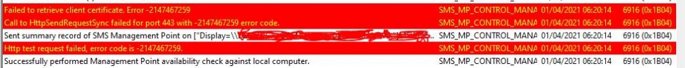

I have an issue with my MP which resides on my secondary SCCM server and it uses https and PKI certificate, i just don't know what happened, I just realised that my windows patch compliance is drooping and clients are active and have a grey icon, went into the mpcontrol.log found error attached, all certificates are still valid. please help

This has been sorted out, client certificate option was selected on an environment without client certificate, removed the option and the environment worked perfectly.
