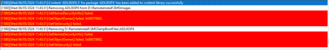

When trying to distribute the boot image to DP it give the following errors and does not show in RemoteInstall\SMSImages folder

when removing the current "Deploy this image" and setting the new boot image as "Deploy this image" it shows in the RemoteInstall\SMSImages folder
and when trying to pxe boot a device get the following error Windows Deployment Services Encountered an Error: 0xc000000f.
