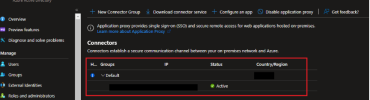

Dear Team,
We installed and configured one of the business apps on the terminal server and provided users remote desktop access to the application.
Can the on-premises application be connected to Azure AD so that users may access it online?
I'm not sure whether the steps below meet my needs, however I started installing the connector and got stuck in the middle,
  • Installed the connector application "Application Proxy Connector" on the terminal server, and the application proxy's status in Azure AD is active,
  • Planned to integrate the on-premises application that was already installed (on-premise server) into the Azure AD using application proxy, however it requires an internal Url and segment. I'm not sure of how to get the internal Url from the installed application,
Please help with this request.
can you access the App as a Web Service? hence why its asking for your internal url. The external url is the one that can be accessible via the Proxy from internet.
