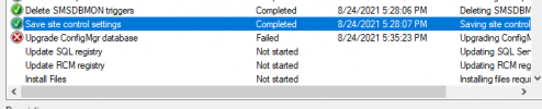

PENDING [Failed]:Upgrading ConfigMgr database. Check cmupdate.log for details.
  • Thread starter Thread starter Alex55555
  • Replies Replies 8
  • Views Views 5K
A
Alex55555
Guest
Hi all,
Trying to update my SCCM from 2103 to 2107 but if failing on
the erro in the log is:
tried to check my SQL server nothing spesial
anyone can help?
