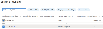

Aware that the A2_V2 VMSS is outdated and MS want to move away from them, SCCM only gives the standard options of small/medium/large
and not any choice of VM Type. We have had a new VMSS A2_V2 allocation to our sub and are in fact able to manually create an A2_V2 Size VMSS
