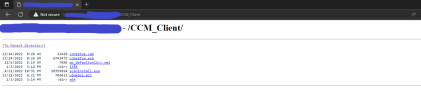

Client installation (ccmexec.exe) via switch "/mp:" also fails (tried server name/server name + fqdn/http://servername etc.) but works without problem when specifying /source with the files on a different shared folder or local folder.
We can browse to the client files via webpage just fine.
