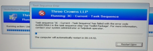

I'm getting the above error. I thought related to drives so I ran Diskpart. Then I received error 0x800700A1 and noticed an old server referenced in event viewer. Checked configuration manager found site node still present - attempted to delete, failed due to component manager being installed. Removed all servers apart from configuration maanger and site system. Removed the component manager entry in registry. Resarted SMS_SITE_COMPONENT_MANAGER service. Deleted server from configuration manager, rebooted. I'm still getting the error 0x00000056 while imaging.

can you attach the error screenshot and smsts.log file. If you cannot do that here, you can email me the logs and screenshots here: support[@]prajwaldesai.com
I'll post the screenshots. I'm failing to copy the smsts logs to another device or USB to share the log. Any suggestion?
